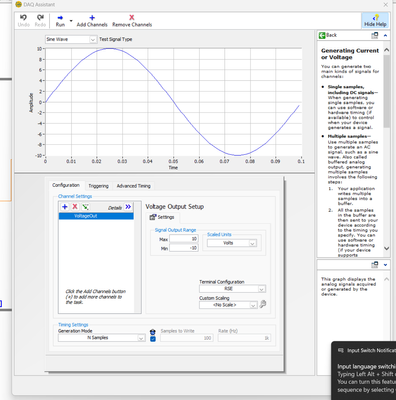

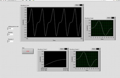

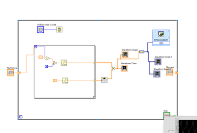

 I have a program shown above, whose output i want to send to an oscilloscope through daq assistant. when i connect the array/waveform to daqassist, LabVIEW adds a convert to dynamic data express, whose output is also shown. But I get a buffer error for the daq assistant, what settings should I use to fix this. PLEASE HELP. p.s. I know my program is also inefficient, tips to make it better is also appreciated, thank you.

Your VI is very inefficient: to make it better you should read this and use plain DAQmx functions!
I would read the error message as "you write new samples too often"…
  • Why do you need a shift register and two controls to set the number of iterations of your FOR loop?
  • Why do you need to calculate sin(pi/2) so often? Why not use an InitArray function with a "1" as input?
  • Why do you need 4 charts/graphs to display the same data array?

  • Im using 4 charts so that i can see what the convert to dynamic data had done to my input array.
  • Im not using the direct waveform functions, as I can't figure a way to multiple the Blackman window to every pulse of the sine wave separately.

my issue is that I don't understand how to output a set of values in an array through daq assist. so far I've only sent out waveforms generated by the simulate signal. Ive attached the LV 2019 file below. Thank you!

  • I'm not sure I understand your question of which sample rate i want to use.
In the DAQAssistent you activated the checkmark to use the timing of the waveform signal, but you don't provide a waveform in your VI. All you create is an array of samples, with no timing information! The DAQAssistent most probably handles your array as a waveform using a dt of 1, so it outputs the samples at 1Hz…
What is the desired sample rate in your application?
When you create 20 samples per iteration: how long should it take to "play" those samples over the AO channel?
