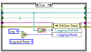

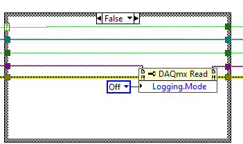

Once you set up TDMS logging, it is not an always save operation. A simple DAQmx property node is all you need. The case statement below is what I use in my programs when the user hits the save button.  (I also give the option of log only, that is, save without seeing the data. This mode is the most efficient.)
Turn logging off, that is, don't save data. But you can still display it, no problem.Turn logging off, that is, don't save data. But you can still display it, no problem.
Save the data. Log only saves it without displaying it, Log and Read will save and display.Save the data. Log only saves it without displaying it, Log and Read will save and display.
@OP When you have time I highly recommend refactoring your code. Right now, it is hard to debug and add features when needed.
