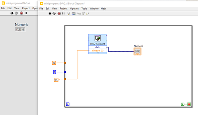

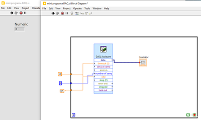

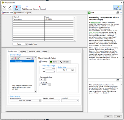

The problem is the DAQ assistant don´t show me the samples acquired when i set the acquisition mode: "continuos samples"
But, as we see in the second image the samples are arriving to the DAQ assistant (Temperature=17,97)

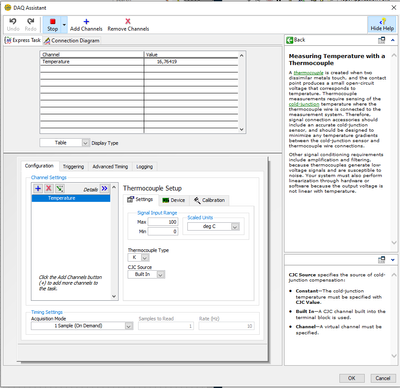

On the contrary, if i set the acquisition mode: " 1 Sample (On Demand)" everything works perfect.
If anyone knows how to show samples in the acquisition mode: "Continuos Samples".   I would be very grateful! 🙂

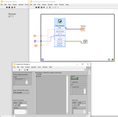

Hi Jorge,
what about some error checking/handling?
Are there any errors in "continuous mode" from your DAQAssistent?
Generic advice: don't stick to the DAQAssistent ExpressVI, try to switch to DAQmx functions as soon as possible…
(2,762 Views)
I have no error.
