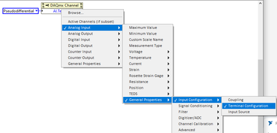

the details are below,
in AI-Voltage-Basic
in DAQmx channel property node
Message 5 of 13
(4,896 Views)
There is no option for "default" in the channel properties but you can find what is the default configuration in the help file "Default Input/Output Terminal Configurations". For the PCI-6110 it is Pseudodifferential.

the trick doesn't work,i should set default so it can run automatic.

I would suspect (but cannot guarantee) that if you never explicitly try to set the "terminal config" at all, DAQmx will *assume* the device's default terminal config.

This is true. I am updating a program where I give the user the ability to change this, which can be a nightmare.
Things to watch for:
  • Certain DAQ devices have BNC inputs that can do differential, RSE, NRSE configurations. ALWAYS go with the differential and do not expose the user to the other options. The inner and out part of the BNC terminal are the two SE inputs used for differential measurements. I assume nobody is going to break out wire connections to the outer and inner part of a BNC connector. This can also be confusing to the end user as the specs say 16 channels, but you only see 8 bnc connectors on the device.
  • Other DAQs have wire connectors; here people can rewire their inputs. So if they set ai0 to differential it is really ai0/ai8 that need to be wired. Note the DAQmx API lets you get measurements from the same terminal with different terminal configurations. I don't expose the user to that, but be aware. For example if the user chooses ai0/ai8 differential measurement, I don't allow them to also take a RSE ai8 measurement simultaneously, although the DAQmx API allows it.

so how can i set  terminal config for different physical channels like this?
