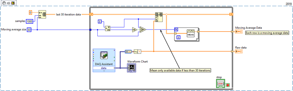

Anyway, here is a modified version based on your description.
Moving average for DAQMoving average for DAQ

Thank you! But it seems like this also doesn't give me a vector for the average that I can then subtract to my 31st second of raw data. I feel that it's my fault that I might not have explained it clearly enough, but I hope that with my previous reply to your comment it gets a bit more clear what I need to do.
(2,872 Views)
