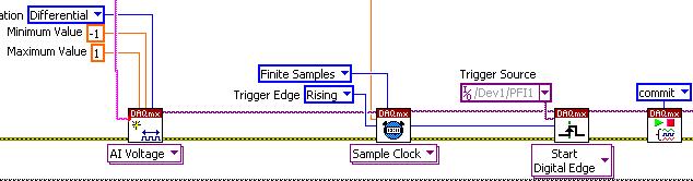

Initialise channels and trigger (happens once at at start of program):
initialise channels and trigger

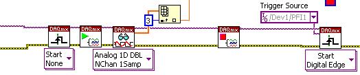

Every 2s get a single multi-channel sample without trigger then reinstate trigger:
Get a single sample without trigger then reinstate trigger
Please could someone explain when I should use the "start task", "stop task" and  "commit" the help is quite vague and unfortunately I end up "hacking" until it works which isn't the way I like to work! I am using a USB 6211.
The program above works OK but has an intermittent (approx. every 10mins) error on the "stop task" before reinstating the trigger. (from memory the description was "DAQ task not finished")

yes the code is structured to do one thing at once.
The large data sample every 100s is done using a finite triggered sample. I wait until this is finished then the new task is configured every 2s and run. Then this task is stopped and the original task is reconfigured. At some point the triggered task doesn't release the hardware to allow reconfiguration causing the error.

Al1234 wrote:
...Then this task is stopped and the original task is reconfigured....
Al
You only have to configure it once and just start and stop the task.

That might be the solution. I was reconfiguring parameters individually but I'll try it the proper way using tasks configured by MAX.
Al
Message 6 of 9
(3,944 Views)
I hadn't initialised separate tasks correctly for each operation. It now works perfectly!
