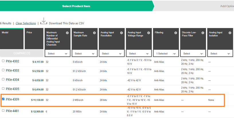

But then looking at the Analog Input Hardware Selection Pages on NI Website
It seems to indicate that the Discrete Low-Pass Filter is NOT on this product.  WHICH IS CORRECT!?

Looks like 4309 does not have this hardware for LPF as adding a 4305 allowed me to access this property.
