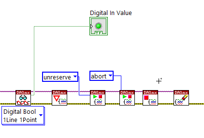

This thread may offer some clues, but I have seen this behavior before with AI tasks. I gave up a bit, and decided to reuse tasks where possible. Is your system 32bit? I found it was worse with 32bit systems. You can try inserting some primitives, like below and see if they help.
mcduff
