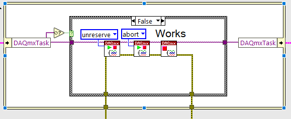

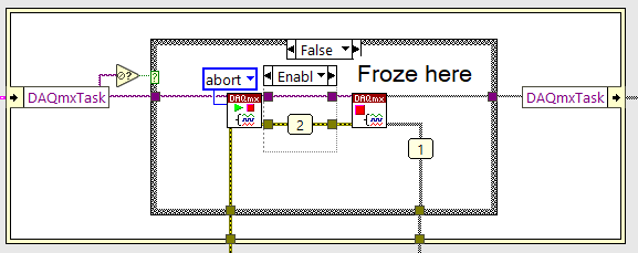

Can't post the VI here. Attached are picts that show where it freezes.
An abort then stop, freezes in the Stop VI, unreserve, then abort, then stop, no freeze. Undocumented state transitions??
You realize a stop is implied by abort right?  Without a task name and with autocleanup default your code just absolutely makes no sense!  Yup- that is shooting yourself in the foot!  Ready...Fire, Aim!.  Nope, FIRE, Aim for the Dr. office wincing the whole way hopping on the good foot and yelling "Ouch, Ouch Ouch!"

The original code/thread was not posted by me. In a related thread, I had a similar problem and tried using primitives, and reusing tasks where possible, and seemed to work. Here is the link  you replied to that thread also.
What you said earlier about the DAQmx transition diagram made sense, so I went back and changed my code according to your advice, and ended up with a frozen LabVIEW. I am not saying what I did previously was right as I agree with what you are saying, but for whatever reason it works, and the what is shown in the diagram I sent does not work.
When a task is aborted, it is returned to the Verified state. If the task is running, it is stopped as soon as possible and is then unreserved. After a task has been aborted, you can continue to use the task. However, you might need to transition the task back to its previous state before continuing the specified operation. (This is what the Stop is for. )
Unfortunately, I cannot use the same task over and over. This is not a production environment but a R&D environment, so tasks/devices change all the time.

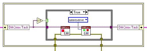

@mcduff:  I went back to that original thread and admittedly only skimmed it.  Did you ever go back and try to test methods with *NO* calls to abort the task?   I've never run into a need for the abort task option, continue to be doubtful that it's a necessary or important step, and pretty strongly suspect it to be at least potentially harmful.   Does it not work to stop the task without an abort, like this?   (And unless you explicitly reserved or committed the task before starting, you might not get any benefit out of the call to "unreserve."   At least according to the DAQmx state model as I understand it.)

@Kevin_P
Your suggestion works! My real problem came on a 32 bit machine that I do not have here to test. Just stopping the task would eventually lead to a resource problem, where if I am remembering correctly, abort did not have that problem, or that problem arose more slowly.
