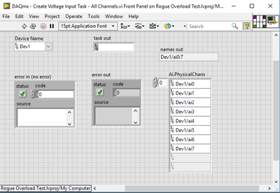

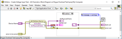

I am trying to use the DAQmx Flatten Channel String VI, but it doesn't seem to be working correctly. I am putting in an array of channels and it is outputting only the last element of the input array...not a CSV string like it is supposed to. Has anyone else run into this?
See attached VI and screenshots for an example.

OK, well since you edited your post to add the example, I can see that it doesn't just output the last one, it outputs a string ending in "ai0:7", which is it being "smart" and compressing it down to show that it uses all 8 channels in a minimal amount of space.
Try removing just one channel in the middle, like #3, and you'll get something like Dev1/ai0:2, Dev1/ai4:7,
(2,909 Views)
Ohhh, I see now. I was interpreting that zero as PORT zero, not CHANNEL zero THROUGH seven. Thanks for clarifying that for me!
