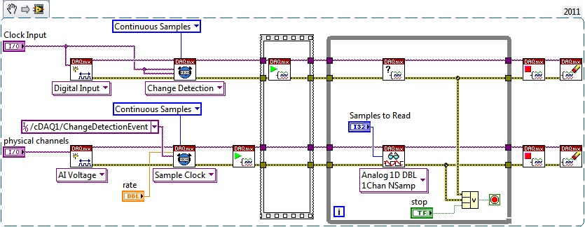

I believe Brad was describing something like this:
You should be able to configure a DI task using change detection timing, which will generate a clock (called "/<chassis_name>/ChangeDetectionEvent") on every rising and/or falling edge of whichever lines you want to use.  You can then use this clock to sample your analog input.
If you're using the 9401 and you have another task running on the module (e.g. an encoder task) you'll want to make sure to reserve both tasks running on the 9401 before starting.

Hi John,
thank you very much for your idea. I tested it and, as far as I can see, it works. Now I'll see if the aquition rate is sufficient.
