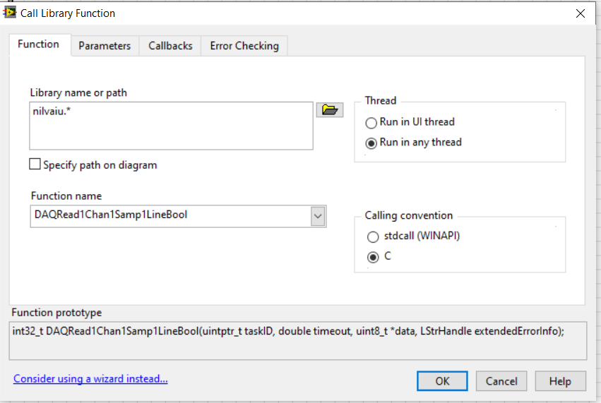

I'm refactoring an old project that uses this .vi:
DAQmx Read (Digital Bool 1Line 1Point).vi
Sometimes (not every times) this .vi fails to compile for a problem with a missing library/driver ..
Maybe this depends on this configuration:
I tried to fix it setting the library file path to C:\Windows\SysWOW64\nilvaiu.dll and C:\Windows\System32\nilvaiu.dll
but nothing changed.

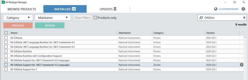

There's a way to 'fix' the installation ?
I mean from the NI Packet Manager which Product I need to REPAIR to fix them?

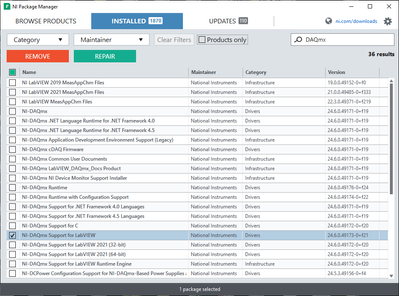

Try repairing NI-DAQmx:
or repair just NI-DAQmx Support for LabVIEW:

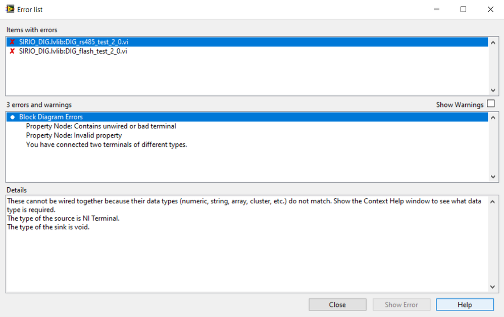

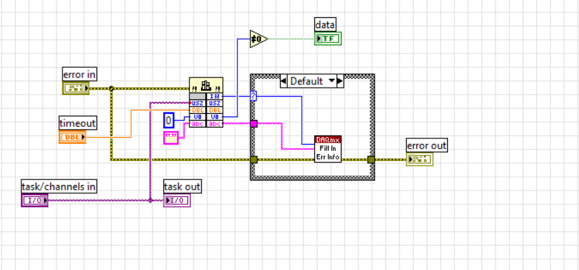

I fighting again with DAQmx ... I have a couple of old VIs that will not compile because of these errors:

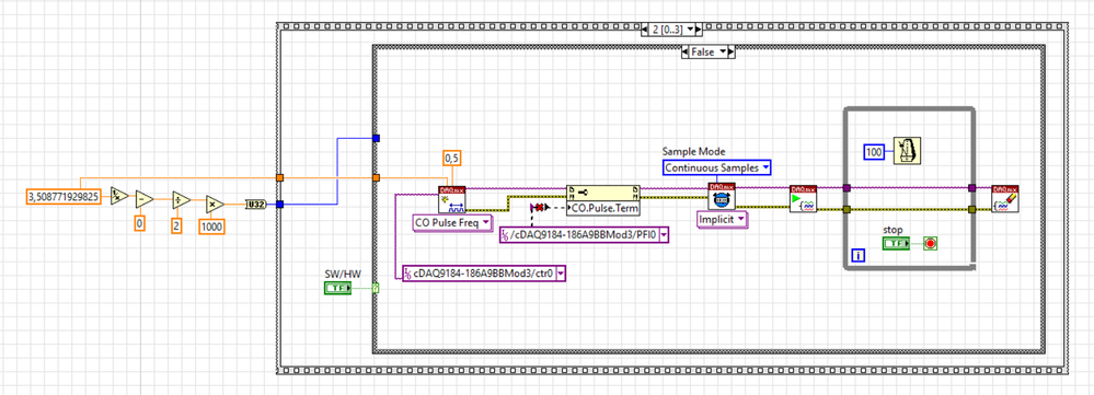

Both VIs uses a Channel Node in this way:
But as you can see the Channel Node is not correctly referenced/populated .. and I can't understand where's the problem.

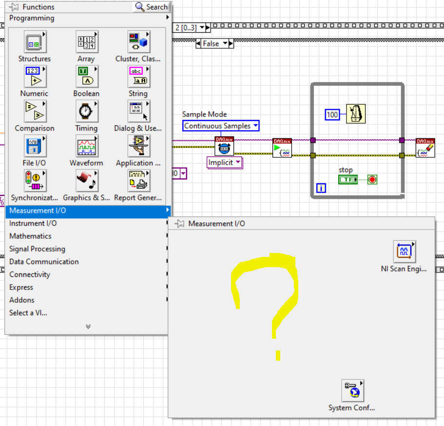

And moreover I finally noticed that this section of components pallette is not populated with DAQmx items:
I tried to repair NI DAQMx support but nothing changes.
There's a way to force LabView to update the component pallette ?
I'm missing packages?

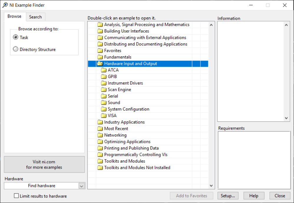

And also examples are missing:
BTW I'm using LabView 2013 SP1.

Hi Michele,
And why did you install DAQmx2024Q3.1 when you still use LabVIEW2013SP1?
This combination will NEVER work!
Please install DAQmx13 to DAQmx16 for your LV2013 installation: this is the suported range!
