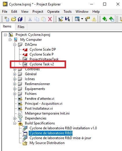

My project with the task:

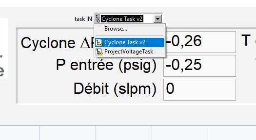

In the Development Mode I have access to the task and I measure the correct values.

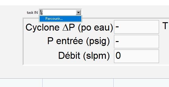

In the build, I don't have access to the task.
What I am doing wrong?

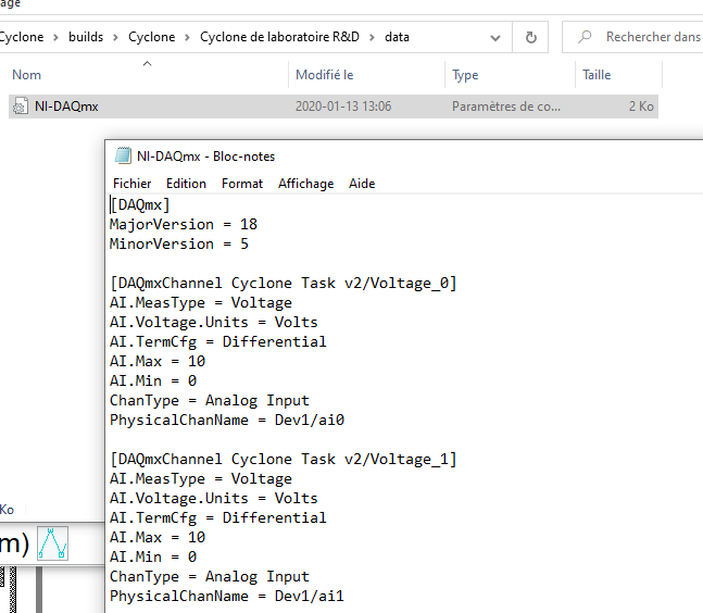

In the data folder of the build I have the Ni-DAQmx.txt file.

You need to make sure MAX is installed on the PC where you are having problems.  It looks like you don't have any tasks created there.

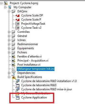

I just created a new Application with the same properties than "Cyclone de laboratoire R&D" and now it's working...
Jean-Marc
