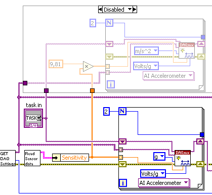

Here is the code:
the upper, disabled part is the from the last programm version,
wich will result to wrong results (in g but not in m/s^2) in
DAQmx Read (Analog 2D DBL NChan NSamp).vi
That is a real bug in DAQmx 9.1 that the conversion to m/s^2 is ignored!

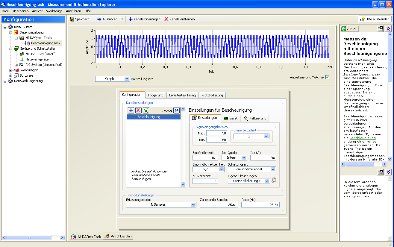

Hi Tobias,
I can reproduce the bug in MAX without programming in Labview:
1. unit=m/s^2 The sensor sensitivity is 10mV/m/s² = 0.1V/g, I use a acceleration exciter  159 Hz, with 10m/s² eff,  14 m/s² peak.
But the result is in g (+/- 1.4 g)
2. unit=g
Peter
