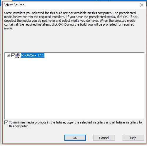

I am trying to build an installer for a simple DAQmx application (I tried to make it as simple as possible for my first installer, just to prove I can make one), but when a click 'OK' to finish the build specification, I get an error stating that Labview can't find my DAQmx installer. I attached a screenshot of the error.
I am using Labview Home and Student edition 2014 currently, and have been keeping it up to date when the VI Package manager when it prompts for updates. I had also tried to build a similar installer using the full version of LV 2014 at work, but also had issues finding the DAQmx installer. What gives? Is this an add-on I need?

Jeff.  You need the installer for DAQmx to build the installer for you application.  you do have DAQmx installed but do not have a local copy of the installer.  you need to insert the media to copy the installer for DAQmx to your harddrive
