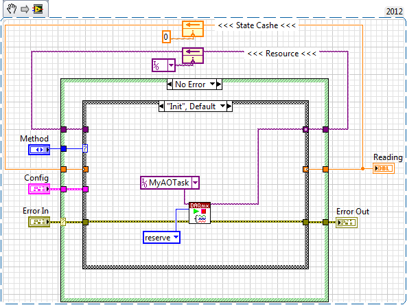

This is exactly why I ALLWAYS hide my DAQ Tasks inside a "Resource Module"
As I use the term a "Resource Module" is a special case Action Engine tha exposes only that subset of functionality that a specific project needs to take on a given resource external to LabVIEW.  And, it provides a single point of entry to access that resource by keeping private data private.  Had you used the technique here you would have had one vi to look at.  and, there likely would have been no "Reconfigure to add channel" method available to cause trouble.Smiley Wink
