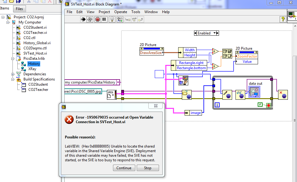

I am having a lot of trouble to use the network published shared variable with a picture.
I always receive the message Unable to locate the shared variable in the SVE,

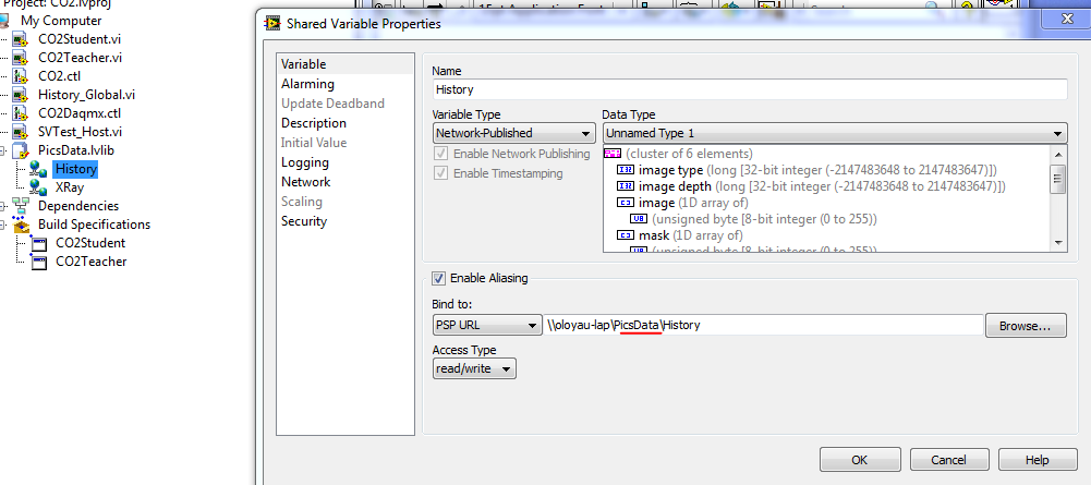

What is supposed to go into the chain \\<machine-name\<process>\<variable> for process name?
How should I configure it?

Does your variable show up in the Distributed System Manager? (after deployment)
Does your VI work if you use a Shared Variable Node instead of the API?

No I cannot see the variable in the distributed system manager,
Nor my VI works with a Shared variable node, see attached screenshots.
