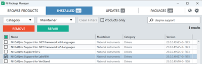

In NI Package Manager, make sure you have the NI-DAQmx Support for LabVIEW installed. If it is not showing up under the INSTALLED tab, install it from the PACKAGES tab.

That was the problem! The packages tab was not visible at first. Finally found how to display that. Found the NI-DAQmx Support for Labview check box. One check box, that was it. lol I checked the functionality of various vi's/tasks, all look good. The only one that crashed was the DAQ Assistant. I can place the vi on the block diagram, it tries loading then nothing. I'll further investigate that, but what I really wanted, is now fixed.
