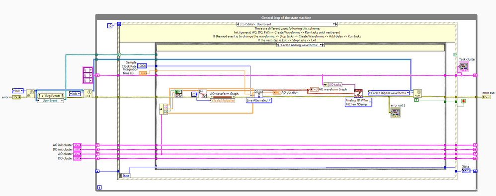

I built a subVI based on a state machine architecture.
Inside this VI, I use multiple DAQmx tasks without problem.

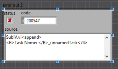

When I call this subVI from the main interface, It has errors coming from the tasks that appear to be unnamed.
I don't understand why this subVI is running properly when it is called directly and why it has errors when it is called from outside.
Could you help me please?

Here is the diagram of the subVI. The error appear when calling the "DAQmx Write" vi:

Dear all,
I found the solution.
When running the subVI alone, there were no apparent error but when called from outside, the error apperas.
In fact, in my stae machine, one state was repeated until an event occurs and then called "DAQmx start task" at every loop.
This was transparent Inside the subVI (this is really Strange because this is an obvious error) but crashes when called from the main VI.
Sorry but this can help people to know where it can come from.
Best regards.

The error text for the -200547 code describes things pretty clearly.  Apparently, you attempted to write data to the task more than once before starting it, and this isn't allowed.
Seems like you need a closer look at your state sequencing logic to figure out why the behavior is different when you run from your "main interface."
