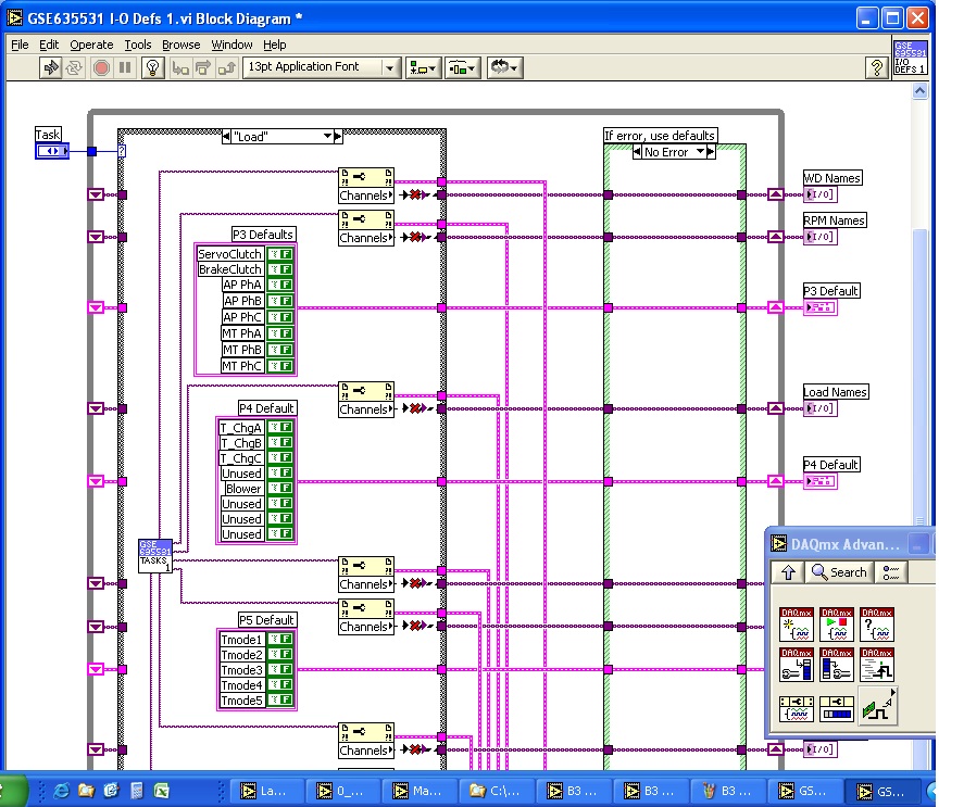

This is a screen shot showing the VI on computer B5. NI-Max 5.0. LabVIEW 7.1. Everything looks normal and the VI runs correctly.

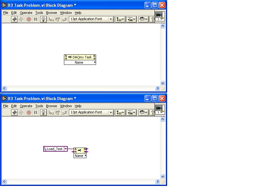

Attempting to create the same VI on computer B3 LabVIEW 7.1 and NI-Max 4.0.3:
  • Placing the task on the diagram shows black color for text that would normally be magenta.
  • Connecting a NI-Max defined task using Create Constant to the terminal changes the icon.
There are no errors in the NI-Max task definitions.
This VI was made on a computer with the same NCE file as computer B3, where it complies and runs with no errors. That computer has NI-Max 4.3. When loaded on computer B3, all the DAQmx task icons change and show errors.

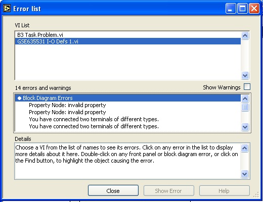

The B3 compiler complains about connecting different terminal types.

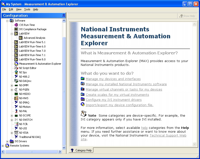

You may be correct.  The NI-Max screen on B3 looks like this:
The screen on the desktop shows entries for LabVIEW 7.0, LabVIEW 7.1, LabVIEW 8.2.1, and LabVIEW 8.5.  I have to support all those versions with it.  Computer B5 also shows LabVIEW 7.1.  So it appears computer B3 is unique.  So the next question becomes: How do I fix computer B3, preferably without disturbing the program it's running, which is critical to keep production happening?
Message 4 of 12
(4,772 Views)
