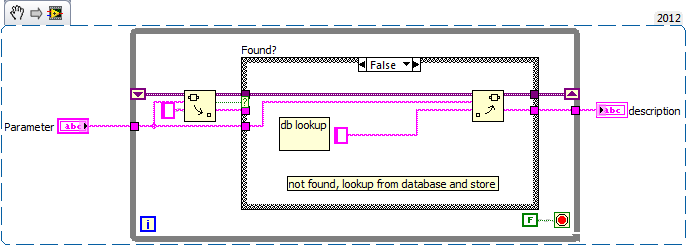

Secondly, try this as an option:
Use a variant on a shift register as an efficient local storage lookup table. When you try to retrieve a 'parameter', see if it exists in the variant lookup table - if it does, return it. If it doesn't, then do the database query to find the description and store it in the lookup table.
Something like this should give you a good starting point:

Thank you very much Sam for your help.
I tried to implement your idea, but it didnn't work properly. (maybe I implemented it incorrectly!)
But I think it wouldn't be the best solution for this problem because there are many parameters which should be compared to the database and the parameters are all in an array with several elements.
