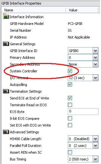

Hi Asill,
What do you mean by the DG535 can enter remote control mode?
I had a quick look at the manual, and there are two possible things you can look at:
  1. Check that the GPIB address is set properly.
  2. On Pg.17, under the section "GPIB problems", it is stated the instrument will respond to commands only if the REN (remote enable) line is asserted. In NI MAX, you can explore this setting "Assert REN when SC" for your USB GPIB. You can see this under the Advanced Settings. If it was not enabled, enable it and save, then try to scan for instrument again.
Victor
(1,715 Views)
Thank you. I'll try again
