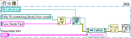

Fortunately there is a way to modify your call library function nodes dynamically! VI scripting is a wonderful thing.  You can dynamically modify (and create) a library function node dynamically by parsing a header file and using VI server tools. Here is a quick snippet I whipped up so that you can see how to modify the inputs and outputs of a prexisting library function node.
Hopefully that's enough to get you started!
