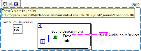

Try running the attached code to check what input audio devices are available to LabVIEW. If nothing is detected, check the audio input device appears in the Sound settings in Windows.
Are you able to verify the input device works with other software, such as Audacity?
Also, make sure your audio device is plugged in and ready before starting LabVIEW. LabVIEW doesn't detect any new audio devices plugged in once it has started.

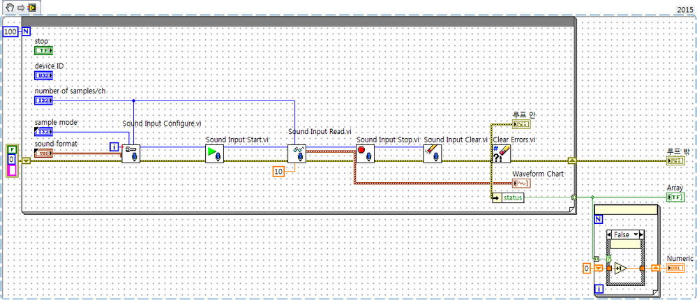

I will share the code I created for device discovery. Device 0 is the notebook's built-in microphone. There is no response on devices other than 0.
And I ran the file you shared, but it didn't show up in the list except the built-in microphone.Dev_detect.png
