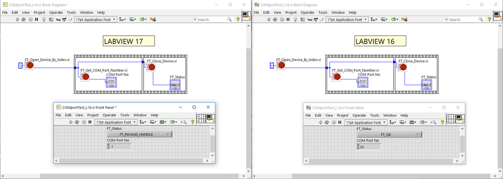

HI,  Did you find a solution for this?
We are having the same issue. Code created years ago it was working fine until upgraded to LabVIEW 17. Also using the FTDI dll
I have run the same code in the same machine with LV16 and LV17 and using 16 works, using 17 doesn't. See below :LV16_vs_LV17.pngLV16_vs_LV17.png
In LV16 I can successfully retrieve the COM port number but in LV17 it gives an error (Invalid Handle).
Is somehow different the way to call DLL on LV17?
Thanks a lot,

The post has been solved, apparently it was not related to the FTDI dll at all.
@Dominigomes
Thanks a lot,
Are both LabVIEW versions the same bitness (32 or 64 bit)? There should not be much difference in the way 16 and 17 call dll functions.
Maybe 16 is started with administrator privileges and 17 is not? Or did you start 17 while 16 was still running? (Just guessing here).
Do the CLFN return an error? That would give more information...
Apologies for that. i was not sure if I should open a new post. I can open it if it is a better practice
Both versions are 64 bit and both running with Admin privileges. I have tried to run it in all the possible configurations (First LV17 only, LV16 only, LV17 with LV16 opened, etc) and it is always the same result.
The CLFN does not return any errors.
I have been in touch with the FTDI technical support and they claim it must be a LV17 issue.
Any idea on what to try next?
Message 6 of 9
(10,071 Views)
@Dominigomes wrote:
The topic is the same, so you're not violating any rules. But a "solved" thread could get less attention.
You might want to start a new thread. But please link to this thread (or that might be the first answer).
Note that you can improve on the title "DLL call problem". "FTDI DLL: works in LV16 but not in LV17" or something like that better covers the topic.
That is of course the easy way out. Reality is that there have been most likely very little changes in that part of LabVIEW so it's highly unlikely that a properly working DLL would suddenly stop working because of a new LabVIEW version.
More likely, the DLL (or the VIs interfacing to the DLL) always had a problem already, but for some obscure reason this error was masked by something in older versions of LabVIEW. Now the error surfaces!
Unfortunately, claiming that everything with a DLL is fine because it can be called in one version of a software is a very tempting but fundamentally flawed argument.
It's even very likely that it could still work with LabVIEW 2017 on other computers. But not having any hardware to test this we are pretty limited in what we can help here. FTDI support could at least download an evaluation version of LabVIEW and investigate on their side.
Rolf Kalbermatter  My Blog
