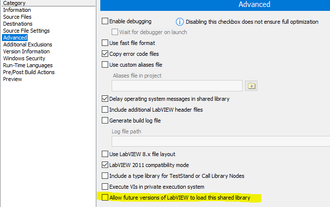

My understanding was that a LabVIEW DLL is always initialized to be executed in the RTE in which it was compiled and then called out of process EXCEPT when it determines that it is called by a LabVIEW process which has the same version in which it was compiled. This seemed to work in the past like this, so I'm not quite sure what happened.
There was a change in recent LabVIEW versions that allowed compiled code to be executed in newer RTE versions when available. I was under the impression that that was only introduced with LabVIEW 2016 but may be wrong. If LabVIEW 2015 has this option too there should be a setting in the Advanced Build settings of your Build Specification to not allow execution of the compiled code in a future LabVIEW RTE and you may have to enable that checkmark.

@Cisco wrote:
I don't understand too, but I can confirm that the dll compiled with LV18 doesn't run on a computer with LabVIEW 2018 and LVRTE 2019... Are they some options in builder to solve problem?
Read my response last edited 5 minutes before your post, which added the info about the build settings to prevent the compiled code to run in a newer RTE than what it was created in. This feature was mostly created for exes I believe and should be working there but something makes it apparently break for LabVIEW DLLs.

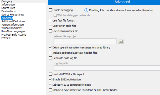

You're right, sorry, I'd not all read. Effectively, we have this new option (not in LabVIEW2015).
LV15:
LV18:
I will active it and do a test, and normally my problem will be solved! It would be great if I could make something like this with LV15 (the smallest version of rte used), but I think I can live with this solution… 🙂
