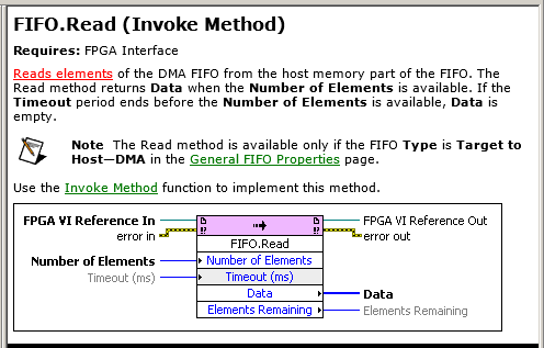

Just to double check:
An invoke method for reading DMA FIFO : reads and removes the oldest element(s) from the FPGA FIFO ?
I mean it removes after reading? Porbaly removes.
It is not expelicitly mentioned in the documentation:
(2,413 Views)
Accepted by topic author Cashany
Yes, the read is destructive (meaning it removes the element from the FIFO).
Cheers!
