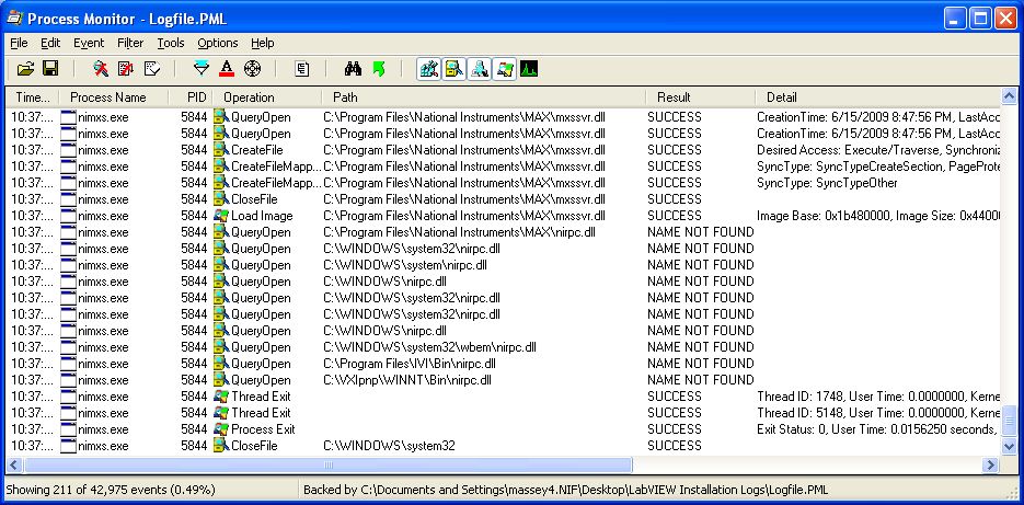

As a followup to the comment about MAX not working (and to leave myself a bread crumb trail that I might be able to find should I ever have to repeat this) I have discovered how to fix my MAX problem.
I knew that the MAX problem was related to the "NI Configuration Manager" (CM) service and its failure to run. The "NI Device Loader" and "NI PXI Resource Manager" services also would not run but on their service properties dependencies tab, the CM service was listed so it's not too surprising that they had failed.
Looking at the General tab for the CM service I see that the executable behind the service is "C:\Program Files\National Instruments\MAX\nimxs.exe" so I copy that string to my clipboard.   Next I start up SysInternals Process Monitor ( http://technet.microsoft.com/en-us/sysinternals/bb896645 ) and setup the "Filter" so that it will display only entries whose "Image Path" "is" "C:\Program Files\National Instruments\MAX\nimxs.exe" and then I try to start the CM service.  After the startup process stumbles, this is what I see down at the bottom of the monitor log file:
It seems that the process was doing a fairly through search for a "nirpc.dll" file but not finding it and finally quiting.
A search of my system with my favorite search tool (   Everything  ) turned up several copies of nirpc.dll stashed away in version-numbered folders below "C:\Program Files\National Instruments\RT Images\NI-RPC\ x.x.x \nirpc.dll".  I picked out the most recent one and dropped a copy into my system32 folder and retried starting the CM service and it worked!
Now my MAX (4.5.0f0) gives me a list of the software on the system.
Doing a search of the NI website for nirpc.dll turns up mention of the fact that it has been known to not install properly. This is just another instance of that.

Hi Warren,
The DLLs in the RT Images directory are intended to be deployed to a LabVIEW Real-Time target running Phar Lap ETS, and they aren't guaranteed (or even expected) to work on Windows. However, It sounds like you already went through the hassle of uninstalling and reinstalling all of the NI software, so short of finding the actual NI-RPC MSI on your installation media and uninstalling/reinstalling (or repairing) it, I don't have much else to suggest.
Brad
Brad Keryan
NI R&D
Message 8 of 9
(5,804 Views)
Thanks for the heads-up about the pedigree of that file Brad. I still can access most of the files on the old "crashed"** system so I can pull the nirpl.dll file out of the old system32 directory and drop it into the new one. Hopefully it work will work at least as well as the wrong file did.
