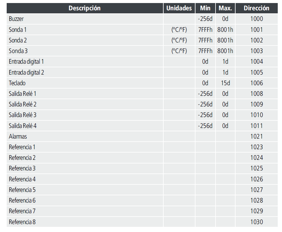

I'm trying the DSC module to communicate with a temperature module, but this, doesn't respect the MODBUS registers addresses, for example to read the temperature, I should query a 0x03 to the address 1001d.
Addresses

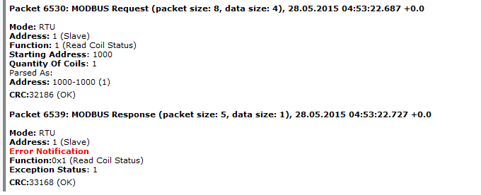

But for DSC to do a 0x03 Query, it expects addresses like 4000, so since 1000 addresses belongs to coils, DSC is doing a 0x01 query
Queries
My thermometer doesn't even has a coils register.
Is there a way to force DSC to do specific queries?

What if you enter the numbers as 401001  or just 400001?
Also try just 1.
The actual protocol doesn't transmit the prefix digit that classifies it as a coil (1) or holding register (4), input register (3).  (Possible I mixed up those last two.)
So the device describing the register with the wrong group of addresses, may not matter.  You might just have to lie to LabVIEW to tell it where it thinks it is supposed to be.
