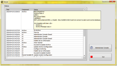

When archiving, Archive Data.vi is unable to connect to the alarm and events database and throws an error.  I can confirm though that alarm and event logging is enabled for the variables that are generated by the Server.

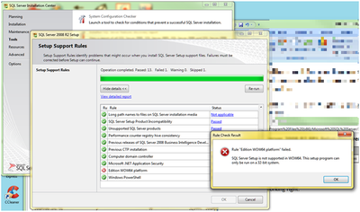

The article points out that Citadel is not used for alarm data, but MSSQL 2005 is.  Although I seem to have a reference to 2005, it appears that my PC is using 2008 R2 SP1.  image.png
Looking at the configuration for SQL server, it seems like maybe the wrong version was somehow installed, but I'm really not sure.

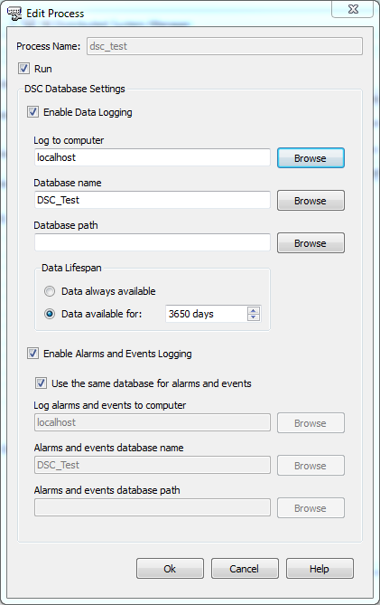

A quick way to test everything is working is to start up the Distributed System Manager, then create a new process with logging and alarming enabled under localhost. Enter a database name, but your can leave the path blank and it'll log to the default database.

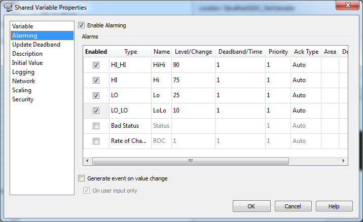

Now create a variable under the new process, and on the Alarming page ensure alarm logging is enabled, and some alarm levels are checked. Also enable data logging on the Logging page.

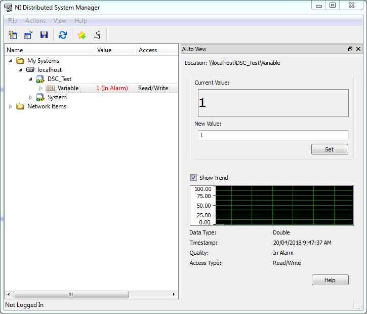

Set a new value for the variable, outside of the alarm range so you will see your variable go into alarm.
Now if you fire up MAX and create an alarm view as I mentioned, you should see your new alarm appear in the alarm log.
