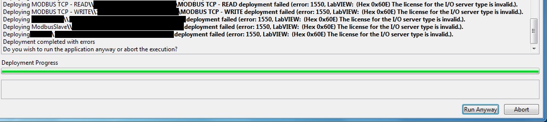

Once I run the controller I get this error#1550:

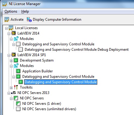

The DSC module seems to be activated in the license:

You mention runtime a bit and show license manager for a development system.  Are you seeing the error on a system with, or without, the development environment?  The DSC runtime engine isn't free and requires its own installation.  If you're seeing this behavior on a system with the RTE, it's not surprising.

I have uninstalled everything and tried again.
This time, I installed the controller and tried to run it (No LabVIEW installed), and it gave a an error:
(error: -1967362042, IAK_SHARED:  (Hex 0x8ABC7006) Unable to start service.)
What I understand is that it is missing the runtime engine.
So by installing the latest runtime engine 2014, the returned error is the same error#1550 as showed in the previous post.
So my question is how to properly install the DSC module at this point, and fix those 1550 errors?

Did you bother to read the last post before going and doing things that didn't make sense?
The DSC module has its own runtime engine (RTE).  The DSC RTE requires a license per computer.  It's not included with the DSC development nor is it included with the LabVIEW RTE.  If you only install the LabVIEW RTE, you won't have access to the DSC functionality.  You require a license specifically for the DSC RTE.
Hopefully you'll read that part this time.  Now, let's address what you did after ignoring the last post.  The program requires the RTE that corresponds to the development environment you built it in.  You mentioned it's looking for 2011.  That means it was built in 2011.  You'll need the 2011 RTE to run that program.  Based on the DSC errors you're seeing, you're working with an executable that will require the corresponding DSC RTE.  The "latest" is useless to you.

Hi luis.m,
Just to summarize, if they developed the application using LabVIEW 2011 and LabVIEW DSC 2011 at a minimum you must install:
-LabVIEW 2011 RunTime Engine (Which is free and you can easily get online)
-DSC 2011 RunTime System (Which needs to be purchased separated):
