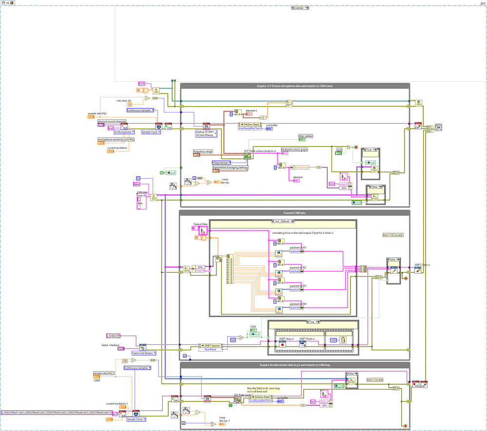

@Jacobson-ni wrote:
I found a few old bug reports but most of the problems are fixed and pretty generic (similar to memory access violation) so we probably won't be able to guess the root cause without seeing any code. Is this a crash that just recently started to happen? What changed from when there was no crash to the current state of the system? Does this happen immediately on startup or at a specific code path in your application?
Taking a shot in the dark there was a recently reported issue with using classes on Linux RT targets so if you are doing that it might be worth looking into what is going on in that bug report.
CODE GENERATING ERROR DEPICTED ABOVE

It was a memory issue involving a queue. I had an open ended queue gathering data but never being read. Thanks for your help! Another participant (wiebe@CARYA) had found it in another thread I had posted Re: "Application stops for no apparent reason".
