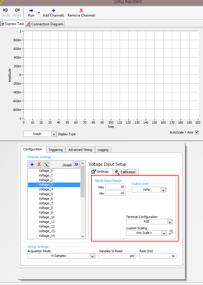

I'm developping an application that acquires data using a compactDaq.
So far, i've managed to leverage the System API and DaqMX to automatically discover the CompactDaq, the modules, the channels,... but now I need to provide a user interface to configure each channel.
So.... do I need to reprogram an user interface for each type of channel or is it possible to use something that already exists? Like, in the DaqExpress vi, it is already possible to configure the channels, also in MAX, it is possible to configure and acquire a channel...
Is there a way to use those configuration user interface, at run time, in my application?

Hi Scott,
I got to the conclusion that it was not possible to use Max's configuration éditor or the one included in the express vi.
So I ended up rewriting part of it myself.
Thanks for your reply anyway,
peper
