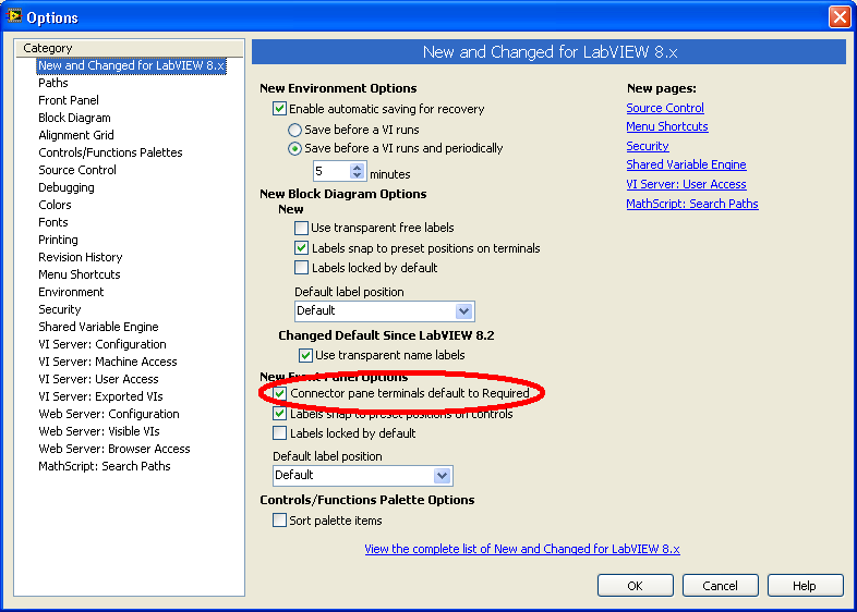

Another one of my favorite LabVIEW 8.5 features is the new "Connector pane terminals default to Required" option in Tools > Options:
Enabling this option causes any new connection of a control (except error controls) on your connector pane to have the "Required" wiring rule.  Here's a screenshot of this new feature in action:
When I wired Numeric, Numeric 2, and Numeric 3 to the connector pane, they were all set to Required automatically.  I really appreciate this feature, because I can't even count the number of times I've had to debug a problem in the past where the cause was the simple fact that I had forgotten to wire an input on one of my own VIs.

I was just thinking yesterday they should make this an option.

Superb feature !

Thanks Darren. i cant wait to get my hand on the 8.5 (so slow IT department i have...).  Just this and the stop in For loop, already worth the update !

This option is way over-due!
Thanks NI for implementing this!
Thank you Darren for sharing!

Very nice.
That is useful in so many ways.

I've been using the HECK out of that feature. No more WTFs...well, certainly not as many as before....Smiley Very Happy
