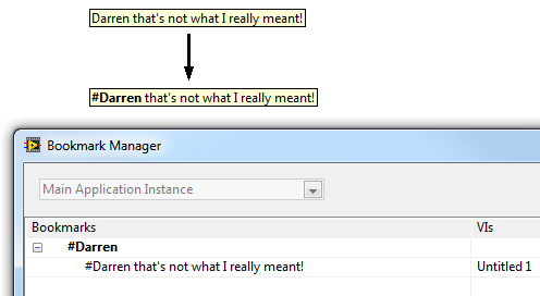

@JÞB wrote:
Highlight as so....
Darren, that's not what I really meant!
Ctrl+M
#Darren, that's not what I really meant!
Maybe I'm missing something, but if you just click right before "Darren" in your example and add a "#" character, the bookmark is automatically created, bolded, and viewable in the Bookmark Manager. How would adding an additional Ctrl-key combo related to bookmarks help you here?
