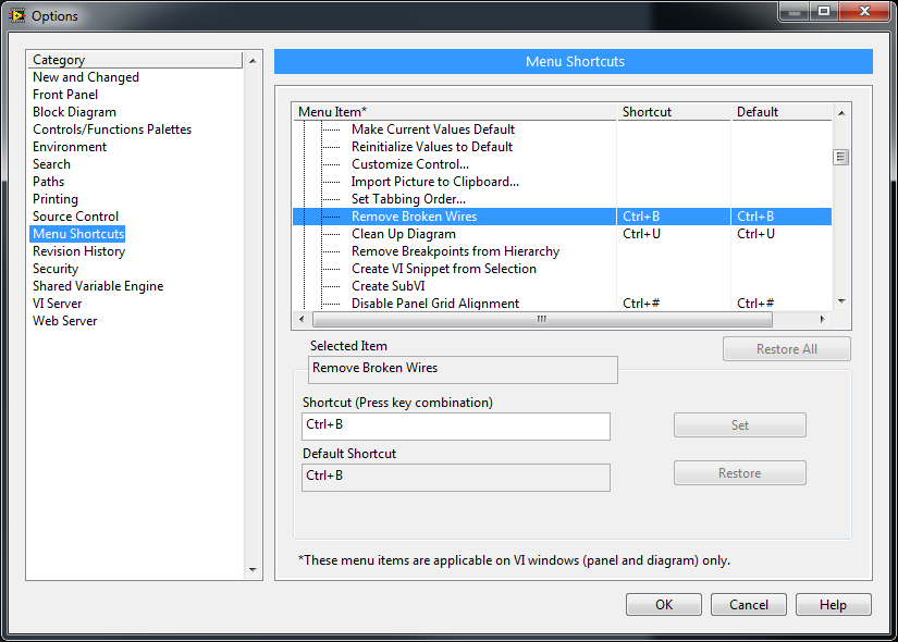

ad. 1a) Yes, I restarted LV after editing INI.
ad. 1b) Yes, I saved INI after editing it.
ad. 1c) Yes, I have LV 13, splash screen says so.
ad. 2) Windows 7.
ad. 3) I tried on block diagram and front panel free labels.
ad. 4) When I edit text (in free label) and e.g. highlight fragment of text and then use Ctrl-B, selected text is changed into "b", just like there was no Ctrl. I tried many ways. When I edit text and e.g. highlith fragment of text and then use Ctrl-B, selected text is chaned into "b", just like there were no Ctrl.
ad. 5) Is there any way to back up INI? I don't have "oryginal".

You can just rename your INI file "labview.bak", then make a new one (or copy the old one and delete all the tokens in it).
One other thought...does the Ctrl-B shortcut work for removing broken wires? Add some broken wires on your diagram and press Ctrl-B...do they go away? If not, then your Remove Broken Wires shortcut has changed, and QuickBold won't work. You can go into Tools > Options > Menu Shortcuts to see what shortcut is assigned to Remove Broken Wires:

I have F2 assigned to Remove Broken Wires shortcut, and thats the problem Smiley Happy
So basicly shortcut for Bold and Remove Broken Wires is the same, OK, now everything is fine.
