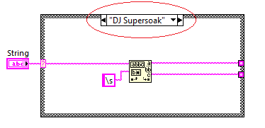

I learned a cool trick from LAVA last week.  There are some keyboard shortcuts you can use while typing in the frame name field of a Case Structure:
 If you're typing in the frame name field and you press Shift-Enter, a new empty case structure frame will be added after your current one.  This trick is similar to my past nugget about how you can add new elements to a ring or enum. Even cooler, though, is if you press Ctrl-Shift-Enter, the current frame will be duplicated.  I didn't know about either of these until last week...they'll definitely be handy weapons in my keyboard commando arsenal... 😛

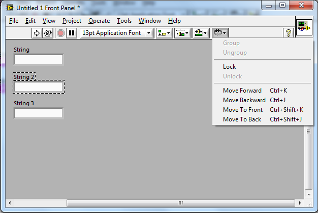

Ctrl+J and K control the Z order of the selected objects (and adding Shift moves the object all the way to the back or front).

Ah yes, thanks Yair.  I should have known AQ knew what he was talking about.  😉  These options are available under the Reorder toolbar menu:
