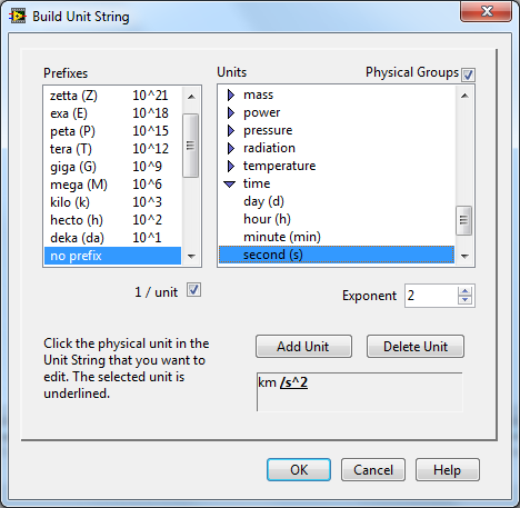

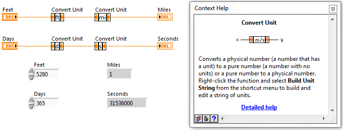

The Convert Unit function is an easy way to convert data from one unit value to another:
If you're not sure what the symbol for a particular unit is, you can right-click the Convert Unit function and choose Build Unit String....
Here, you can pick from a variety of categories (time, distance, etc.) to find the symbols for the units you wish to convert. And as you can see in the screenshot, you can also combine units...for example, I have created a unit string that will generate an accelleration value (in km/s^2).

I showed this to someone this morning and grabbed an expression node by mistake.  It looks exactly the same as the convert unit function and even has the build unit string option.  But it does not work with the example.  The expression node is probably looking for a variable, which is why it did not work (LV 2009, no service pack).
Why do they look the same, yet do 2 different things?
Message 5 of 11
(11,040 Views)
You know, if you used Quick Drop, that mistake wouldn't happen... 😉
Seriously, though, I agree that they need some sort of visual differentiator.  I also don't know why we show the "Build Unit String..." right-click menu option on an Expression Node.  I filed CAR# 223245 on these issues.

Did you accidentally drop the Expression Node instead of the Convert Units function?  See my latest post above...they look identical in the palettes, but they don't work the same.  As I mentioned, I filed a CAR on this issue.
