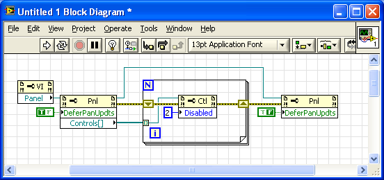

Sorry, I really didn't do a very good job describing my question ...
I totally understand the reason for doing this:
My question was, is it worth doing something like this?:
Now, of course, in making this second picture I ran tests with and without deferring panel updates, and found the answer myself Smiley Tongue ... The answer is yes.  For the second case, with 19 individual controls (i.e. no clusters, just numerics, booleans, and strings) on the front panel, it took about 300 ms without deferring, and about 100 ms with deferred updates.  Of course YMMV, especially with different properties, but this does seem to make a fairly strong case for liberal (though careful) use of the "Defer Panel Updates" property.
Jaegen
