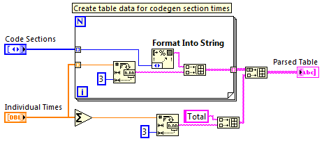

Today's nugget is a quick one.  It's been mentioned several times in the forums before, but I was surprised to discover today that I hadn't actually written a nugget about it.  So here goes...check out the Format Into String function in the code below:
This code is used to construct a table of different sections of code and the amount of time each section took to execute.  The "Code Sections" array contains the enum values that govern the execution of my state machine.  As you can see, I'm using the Format Into String function to turn each enum value into a string.  Format Into String can also turn other data types (paths and Booleans come to mind) into strings, but I have found this enum trick to be the most useful, since there seem to be many times that I need to turn an enum value into its corresponding string value for one reason or another.
