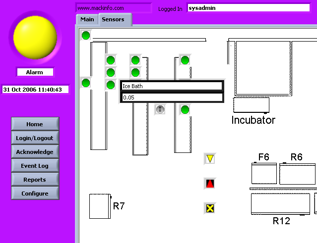

Some more nice picture controls, from an application Ben did for us.  Green is safe, up or down is high or low, yellow or red
is warning or alarm, X is fault, I is inactive.
Matt
Message 6 of 22
(23,913 Views)
Thank you for sharing that Matt!
I will embed the image here.
The above image shows part of the UI that is available in a 21-CFR-11 complient Environmental monitoring system that is commercially available and allows the end users to import a set of map of their facility. They can define the position of icons assocated with the physical location of sensors that are integrated using networks of cFP nodes.
Mouse-ver an icon gives you the name of the sensor (Ice Bath) and the current reading.
Right-click on the icon gives you a plot of the variable vs time.
Left-Click (by an authorized user) allows access to the configuration of the sensor.
Note:
Due to the high channel count of this application, the picture control allowed us to by-pass the " max 550 controls on FP" limitation that existed in earlier version of LV.
Ben

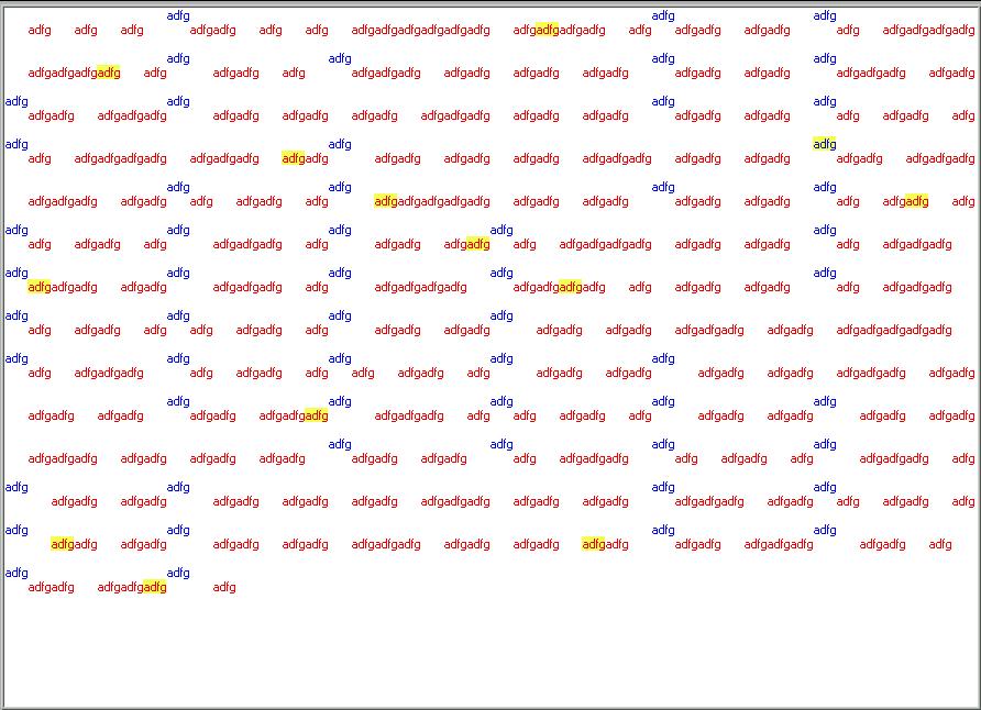

Although I may not have a flashy FP to show at this moment, I think I have you all topped out for working w/ the picture control.
I'll try to keep this short but I'm really excited to talk about it so we'll see how it goes.
It all started w/ needing to stream a picture from a frame grabber to the front panel on a really crappy PC.
Taking the data as an array of u8 and doing the conversion w/ the LV VIs and redrawing for each frame was really slow, about 8fps.
I couldn't use the vision toolkit as it needed to be platform independent.
Solution: Totally disect framework of the picutre control on a byte level (flatten to string), do a repace on the existing string w/ the new data from the camera(inplace function(no new memory)), and then do a concantenate string w/ a blank picture and redraw to the picture control
Result: over 45fps
All that disection....wait let me explain what disection meant
Disection(verb): Opening up every LV picture VI, seeing how the data is structured within each picture type and its appropriate opCode, and then keeping track of each element that was drawn on a picture control so thatt if I needed to modify, say the color of a line amidst 200 lines. I didn't need to redraw all 200 lines w/ 1 haveing the new color, I would just recall the location in the byte stream of where the the line is and the color for that specific line was stored and then change it to the appropriate value.
ex: Picture control framework [32 bits defining total size of following data for entire control][16 bits: opCode(picture part)][32bits: size of data for specific opCode][data of opCode]REPEAT last 3 for every part in control
