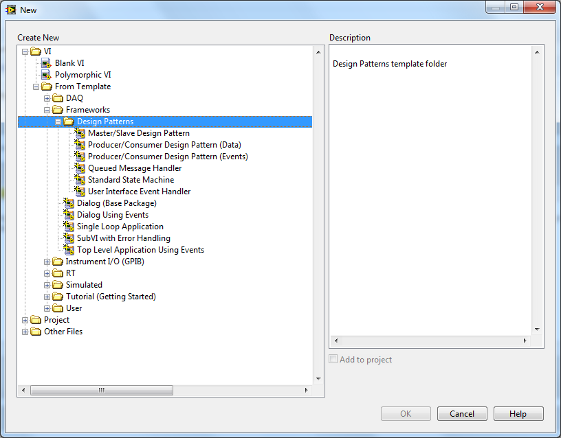

Are you familiar with LabVIEW design patterns?  Using a well-known design pattern for your application in LabVIEW can decrease your coding time, and decrease your maintenance time.  LabVIEW ships with several design pattern templates that you can access from the File > New... dialog:
Some of the most common patterns include Producer/Consumer, Master/Slave, Queued Message Handler, and of course, the ever-popular State Machine.  For more details about standard LabVIEW design patterns, check out this LabVIEW Application Design Patterns presentation.  It's a few years old at this point, but still very relevant.

When I'm asked about tips to learn LabVIEW, I recommend looking at the templates.
Having said that, I wish the NI people would improve the templates. When I took the CLD exam, I started with a template and spent too much time molding it to look like my template.
Opinion? When you took the exam, was a native template of use to you?
Message 7 of 9
(7,738 Views)
When I took the CLD exam, I did not use any of the shipping templates.  What specific changes would you recommend to make the NI templates better?
