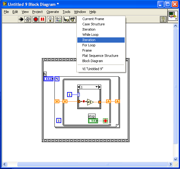

Did you know that there's another debugging menu a few pixels to the left of the Call Stack? The "Step Out" button is actually a menu! Save yourself a few clicks when climbing out of nested structures by holding down your mouse on this button and selecting the level you wish to step out to. You can even step out to caller VIs.
Sorry, Darren, if you were planning to use this for your nugget for next week.
