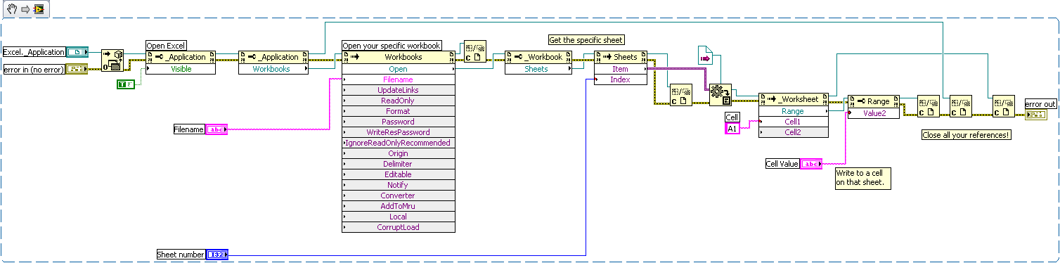

If you don't have the report generation toolkit, you can write to specific worksheets using Automation and property nodes.  For example, below is a code snippet showing how to open excel, open a workbook, open a sheet in a workbook, then write to a cell on a sheet.  It's kind of long, and in the real world it would be broken down into specific subVIs, but you get the idea.

Thanks Andy and RGreg. I have question, is possible storage data with yours recommendations in different sheet in same time, I mean, I have approximately 100 data's to storage, and I try to record 50 data in the sheet 1 and same time, record en the same book the rest data, that are 50 data en the sheet 2

Yes, you can write to multiple sheets within the same workbook.  Using the code snippet I provided before, I suppose you could open separate sheets and write data to those sheets simultaneously, though I've never done that myself.

Your code snippet is intriguing and I could find it quite handy for long term data collection.
Normally I would create new spreadsheet file every day and then manually put them into an Excel workbook as separate sheets.
If I could get Labview to do this for me, as your code seems to do, it would make life easier for me.
When I run this it works as described but it leaves Excel open and the file unsaved.
How would I make this so it runs Excel hidden, saves the file, and closes Excel?
Or I am thinking it might be better to leave Excel and the file open, but hidden during the duration of a test.
But that still leaves the need to save the file and close Excel on exit and at regular intervals to prevent data loss in the case of a crash or power loss.

Well, if you play with the code snippet you'll notice that there's an option to make it visible or not when you open it.  You can shift that to FALSE, but be careful - you could end up with multiple copies of Excel running and not know it.
To save and/or close the file, use the appropriate Workbook methods ("Save", "Save As" or "Close").
Of course, if you have the Report Generation Toolkit try using that instead.  I've found that in most cases it handles Excel pretty well.
