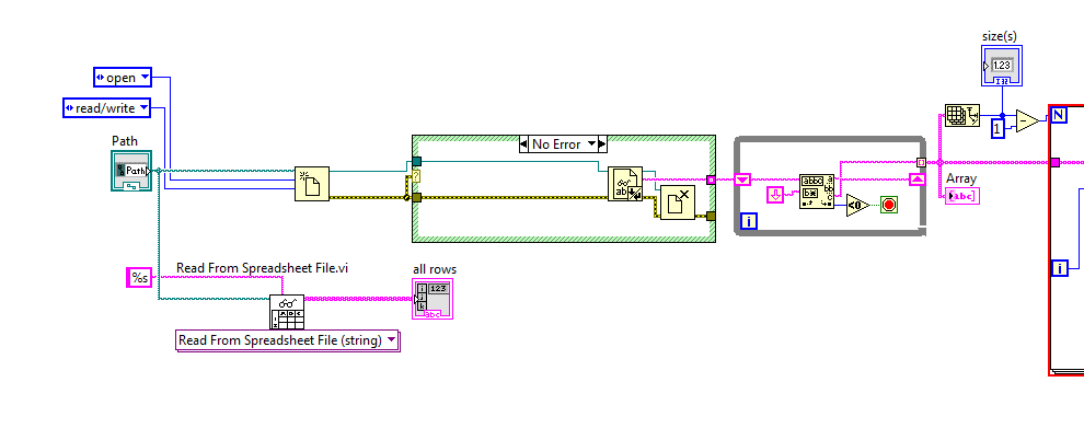

I have quite a bit of string experience with many different programming languages, but all syntax. Have played with some ladder programming but nothing along these lines. So in the orginal data all that needs to be kept is the "DC VOLT METER TEST USING STM VOLTAGE SOURCE", then the last three values without the units (ie 7.9000, 7.9139, and 1.6). So yes the +/-200.00 can be ignored. I have gotten the data file into a array of strings that contain the each line as a whole. Im not looking at parsing through these. I have been trying to use match pattern to do so inside a for loop. Below is the two methods I have been using to sort the data into an array of each line as strings. This vi I am using the top method because it seems to be more compatible with the match case.
