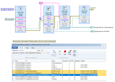

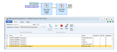

The attached code creates memory leaks.  I don't see anything I can do to clean them up, the Desktop Trace Execution Toolkit indicates the problem is within the express VIs used but are password protected by NI.  I have also tested the Open and Close function without anything else in between and a memory leak still occurs.  Any Ideas?

Yes, my application open and closes the file and the leaks keep stacking up.  This eventually crashes the application with a resulting memory error. I understand that ExpressVIs are not favorable but I believe it's the recommended method for TDM files its in the NI Example Finder and it leaks there too.  I would have expected that using an Express VI for something simple like opening and closing a file would not contain memory leaks.

Yes I have tried to close all the references but it didn't help  the references mentioned in the Desktop Trace Execution Toolkit are not accessible, they're locked behind password protected VI's .  Simply opening and closing the file causes a memory leak, there are no other references to close.  See image.

I agree one memory leak for file open/close is no big deal.  My application only opens and closes the file once but reads and writes a lot.  I created the "TDM file Memory Leaks.vi" which opens, writes, reads and closes the file to demonstrate the memory leaks.  The Open/Close causes one leak but each write call causes another two leaks which means you have a limited amount of writes before crashing the application.
