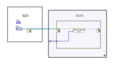

Please take a look at the photo. Yes, this is a garbage VI.  I'm just trying to make something that sums up what the end game Framework would look like.  Is there any value to making Data Value References out of References and then passing those onto asynch VIs where they can be accessed as seen?  There just seems something redundant about it.

Not much value. You use Data Value Reference to pass large datasets without creating duplicates and to work on the original data source.
Since the control reference is a "reference" with no value, creating a reference to a bunch of references does not provide any advantage.

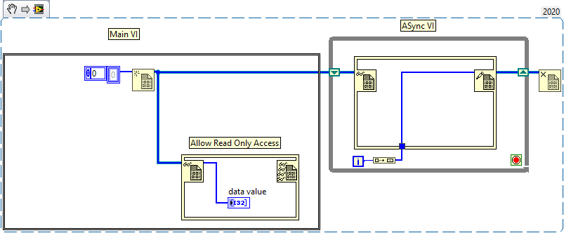

Maybe something like this would be better.
So really, this methodology only useful for indicators and not controls. Just use regular references for controls? But then, the methodology in your VI, there's an ongoing loop that just reads data? Are notifiers required to avoid any race conditions?

@DailyDose wrote:
No race conditions with DVR, like a FGV, do not support concurrent write/read access.
Only recently has parallel read access been added.
I know your example isn’t a real application, but what are you trying to do? You want to update a control from an asynchronous process? You could always read the DVR and update a local variable for your control.

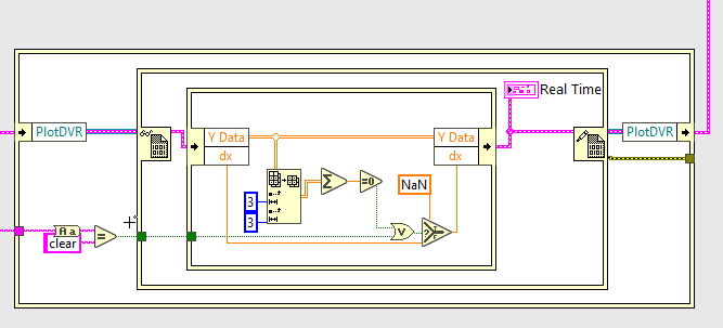

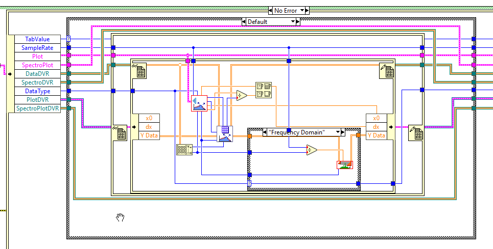

Here are a couple of screenshots for my DVR use cases:
Full Dataset is decimated and then scaled and put into a "PlotDVR". Using the the DVR allows me to send a reference to other loops rather than the full dataset.Full Dataset is decimated and then scaled and put into a "PlotDVR". Using the the DVR allows me to send a reference to other loops rather than the full dataset.After the data is decimated, a message is sent to another loop to read the DVR for display purposes.After the data is decimated, a message is sent to another loop to read the DVR for display purposes.
