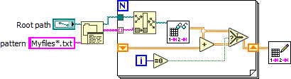

It sounds like you need 2 Delimited Spreadsheet Files and 1 Add.
Qestit Systems
Certified-LabVIEW-Developer
Message 7 of 8
(2,295 Views)
  • One "list folder" (using a suitable pattern)
  • One FOR loop, autoindexing over the files
  • One "build path"
  • One file read
  • One "add"
  • Special handling of first file.
  • One shift register to accumulate the sum
  • One File write after the loop.
  • plus maybe some handing of the headers (they can be left in place for the summing, ignored, and written back at the end). Not shown.
