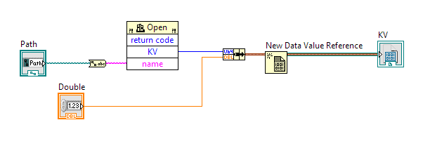

What I'm wondering is, can a DVR be self-contained? I tried using this setup:
Some testing seems to show that this works, the reference does not become invalid. It does feel though like this is not how DVRs are supposed to be used. Comments?

Actually, I'm the one confusing this type of reference with other LabVIEW reference types, aren't I? It is supposed to be self-contained and work exactly as in the picture.

That's not really important. The only important part (for me) is that I connect any random wire to the "New Data Value Reference" function and it will always work. It was not clear to me how the actual value was stored, if it was guaranteed to exist until the reference was destroyed.
The way other references are handled had me a bit confused.

[...] The only important part (for me) is that I connect any random wire to the "New Data Value Reference" function and it will always work.[...]
That is exactly the point of DVR as it creates a handle to the original dataspace the data is located in (compare to a pointer in C).
OK, there are some specific exceptions, but New Data Value Reference will accept all other datatypes.
