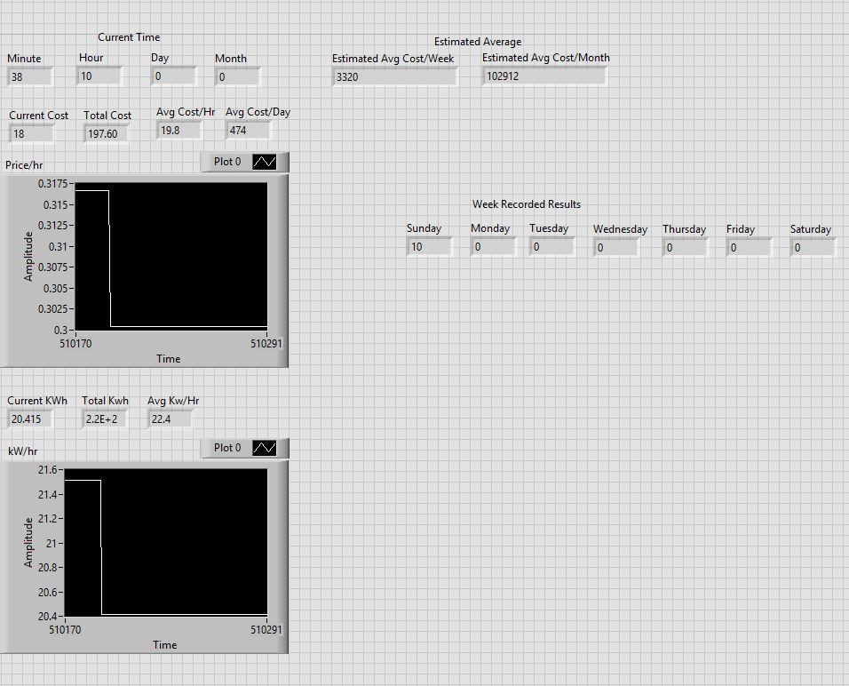

I am currently building a smart meter, and I am trying to record the total cost per day throughout the week. At the end of each day, I am trying record the total cost. (Ex: Suday $400 ..etc). Any suggestions?Weekly Estimate.JPG

I have tried wiring Sunday up to the panel, but with no luck. My end goal is to record the daily total power consumption. Attached are my programs.

Hi Seacreature,
your code should be cleaned up before improving it!
"sumer subVI":
Why do you need a formula node to sum up the contents of a cluster made purely by DBL values?
If you would create an array in your main VI you would not even need the ClusterToArray function!
"price indicator subVI":
There is a InRangeAndCoerce function available!
"power subVI": When working with clusters you should always typedefine them! And use (Un)BundleByName to make your code more readable!
"House power":
- All those clusters should be kept in an array. This way you could do all the computations efficiently (and scalable!) in an autoindexing loop! (Your "sumer subVI" would become senseless then!)
- LabVIEW can handle timestamps quite well, no need to count time manually using min, h, d, and month shift registers! And you can easily get the weekday from the timestamp - LabVIEW will do the calculation for you!
- Store the daily consumption in a shift register keeping an array of 7 values, one for each day of the week…
 - Create a LabVIEW project from your code and keep it in one folder with all (sub)VIs. When attaching your code you only need to ZIP this folder!

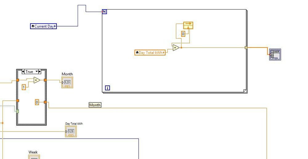

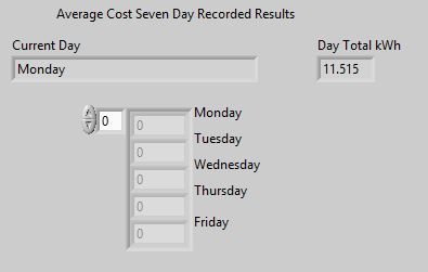

I want to display the first element from the numeric indicator, along with the second element from the numeric indicator and so on.

Attach your VI (note -- this is a file that ends with the extension "vi"), not a picture that we can't edit, inspect, execute, etc.  It will remove the ambiguity that comes when a LabVIEW beginner asks a question without providing enough information to remove ambiguities.
Not clear what you want.  Being able to see the details of your VI (from inspecting the code, not a picture) would let us "guess" and suggest things.

So here's a guess -- you are new to LabVIEW, have been "seduced" by its ability to create a nice GUI, and you are busy designing a WEEKDay SMArt home profile (your capitalization puzzles me) routine without thinking about what you really want to do.
You've made the Classic Beginner Mistake of placing most of your code in a single Block Diagram that is so large that it is impossible to "see the forest for the trees".  There is a lot of duplication that suggests an Array Structure and a For Loop would do wonders.  It appears that you want to do a simulation, but don't quite understand how LabVIEW handles Time (Wait functions work on a millisecond clock).
